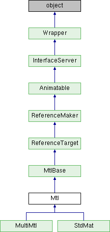

Mtl Class Reference
Class Description
Material base class.
+ Inheritance diagram for Mtl:
