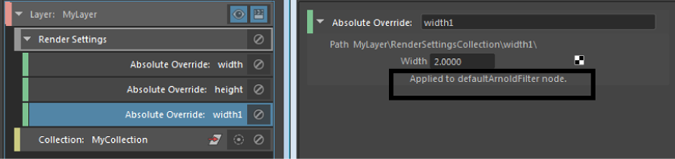

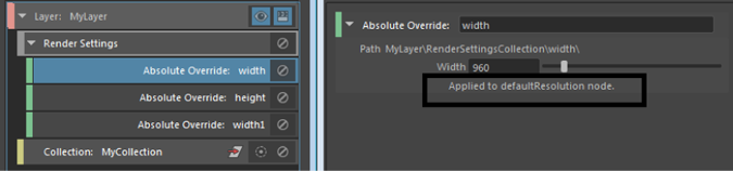

Select any Render Settings override, and the Property Editor indicates the node to which it is applied; for example: Applied to defaultResolution node. This indicator appears on all Render Settings overrides created since Maya 2017 Update 3.
This indicator may be helpful in cases when you create overrides on two or more attributes with the same name on different nodes.
For example, in this case, there are two overrides named width. The Property Editor indicates Applied to defaultResolution node for the former:
and Applied to defaultArnoldFilter node for the latter for easy identification.

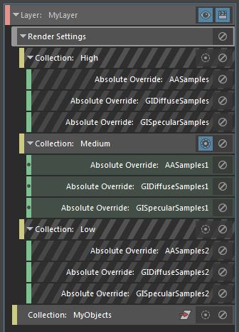

Create Render Settings subcollections
Create Render Settings subcollections to sort your overrides and create multiple Render Settings combinations.
Right-click the Render Settings collection for your layer and select Create Render Settings Collection. You can then drag and drop, or copy and paste your Render Settings overrides to this subcollection.

An example application of this feature is to create High, Medium and Low Render Settings, and convert one set of these settings (Medium, for example) to local render overrides. This way, lower sampling values are used for interactive test renders and higher sampling values (global Render Settings) are used for batch rendering.
