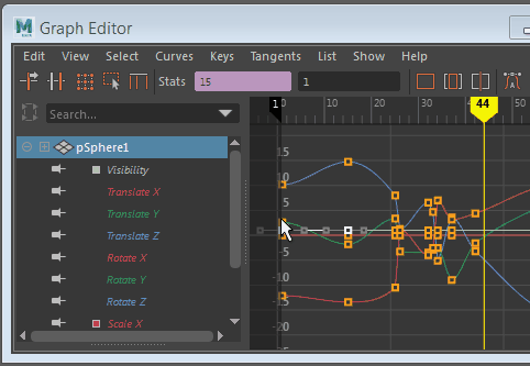

An animation curve is associated with a node in the Outliner portion of the Graph Editor. Selecting a node causes all of its animation curves to be displayed in the graph view.
Each item in the Graph Editor Outliner contains special additional information in the form of a small icon that collapses and expands the hierarchy of viewable channels.

Graph Editor outliner Search
The Graph Editor Outliner Search field lets you filter objects in the Graph Editor, which is useful for tracking down nodes in large scenes. With the object selected in your scene, start typing in the Search Field and any associated objects will highlight.
Channels in the Graph Editor outliner
If an object is animated by simple keyframe animation, for each attribute of the object you select, there will be one animation curve driving that attribute. In this case, each of the animated attributes (channels) of that object will be listed indented below the object.
