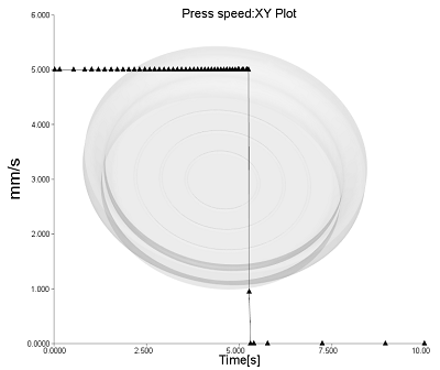

To review the Press speed: XY plot
  1. Click Press speed:XY Plot in the Study Tasks list.
    The Press speed:XY Plot result shows the speed that the press moved at over the duration of the analysis, displayed on an XY plot of speed versus process time.
    • The compression phase consists of two segments:
      • Press compression under speed control. During this segment, the press follows the input specified for Press compression speed at incremental distances.
      • Press compression under force control. During this segment, the press speed that is required to maintain the constant press force is calculated.
  2. Compare these results to the process settings.
    Based on the results the press compresion time might be reduced since the press closes completely shortly after 5 seconds.
