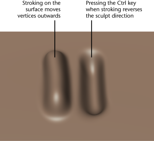

  4. Click-drag the tool cursor across the surface of the model.
    The vertices on the model move slightly outwards along the path you dragged. This path is called a stroke. A stroke appears continuous but is actually made up of many stamp impressions that overlap each other. You can adjust how much the stamps overlap by adjusting the Stamp Spacing property.
    Note: Not all sculpt tools move vertices outwards by default.
  5. To reverse the sculpt direction for any sculpt tool, press the Ctrl key and click-drag the cursor across the surface of the model.
