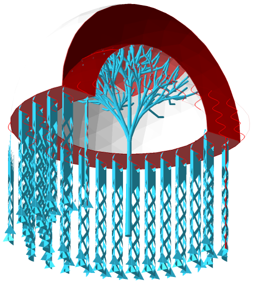

The figure displays a half-cut hollow sphere which contains a concave and convex cluster. A script can include several cluster types with different actions, like polyline supports or bar supports.
