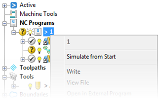

Individual NC Program menu
Use the individual NC Program menu to manage and edit the select NC program.
To display the menu, in the Explorer, right-click an NC program.
Raster — The name of the menu.
Simulate from Start — Click to simulate the NC program. Use the Simulation tab to simulate the NC program.
