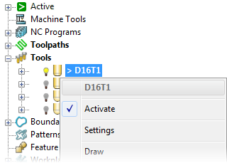

Individual Tool menu
Use the individual Tool menu to manage and edit the selected tool.
To display the menu, in the Explorer, right-click an individual tool.
D16T1 — Name of the selected tool.
Activate — When selected, activates this tool and de-activates any currently active tool. When deselected, de-activates this tool.
Settings — Select to display the Tool dialog.
