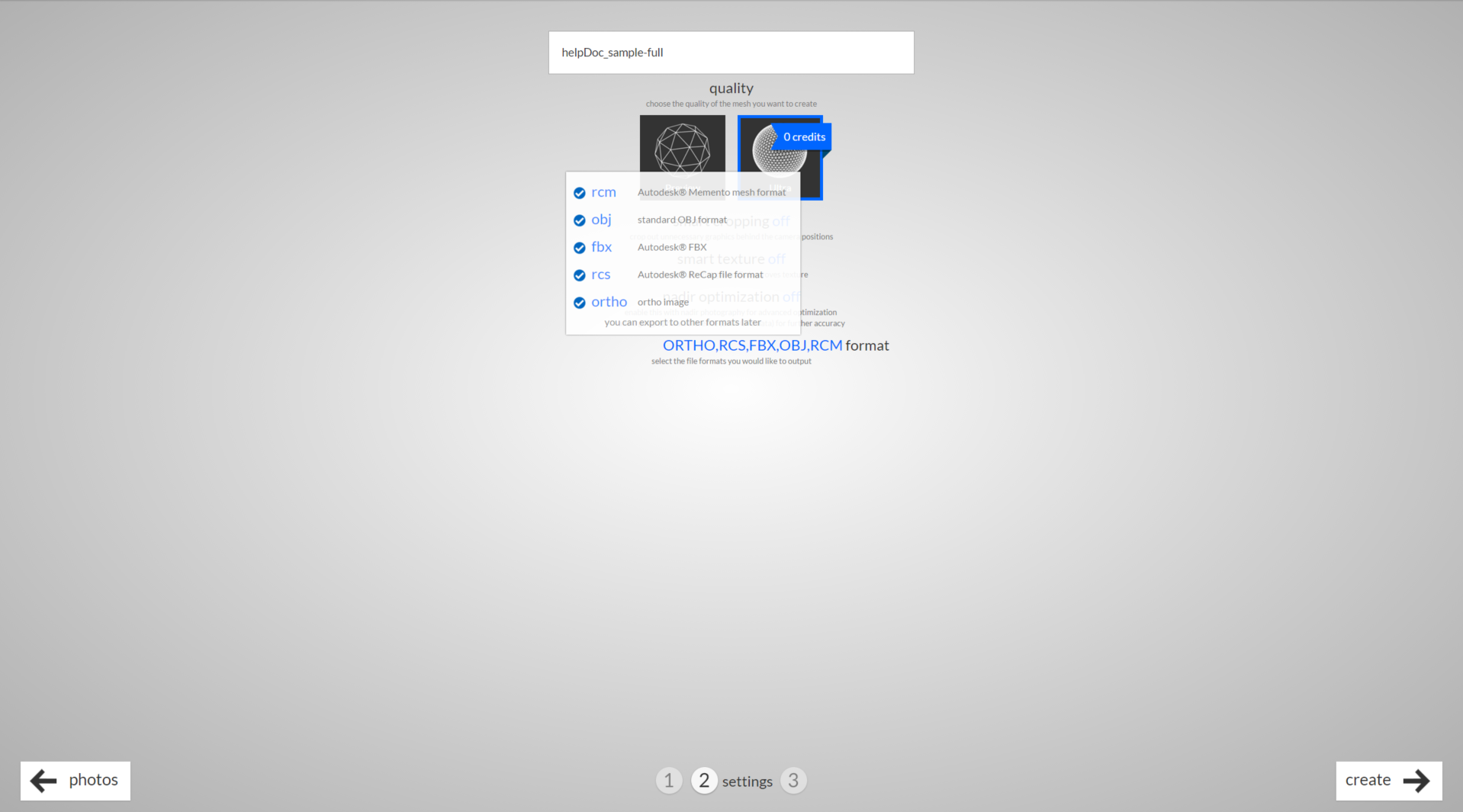

Export
After your automatic Photo-to-3D or combined stitching through Survey Settings, you will then export your photo project in one or more of the given formats, with options for Smart Cropping and Nadir Optimization. Export options are limited without a Pro subscription or cloud credits.
Quality
High-quality mesh model exports for use in Autodesk 3D modeling applications are available in the formats under Ultra. Preview formats simply process at the low level required for the reconstruction to render in ReCap's web RealView and typically give a quick result that suggests the success of your project in a higher-quality mesh. Keep in mind that the mesh is decimated in this view and does not represent the final quality of the reconstructed scene. The web RealView can help you to determine the reconstruction's accuracy (missing sections or inaccurate stitching). File exports must be imported into a relevant standalone Autodesk application (such as ReMake™, Civil 3D ®) in order to be viewed in their true quality.
