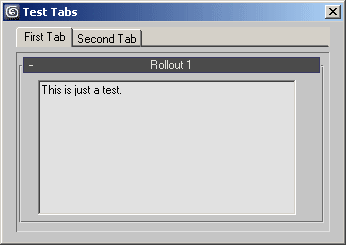

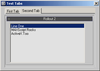

例:
rollout firstRollout "Rollout 1" (
edittext edittext01 text:"This is just a test." height:135 width:262 )
rollout secondRollout "Rollout 2" (
listbox listbox02 items:#("Line One","MAXScript Rocks","ActiveX Too") width:260 )
rollout testTabs "Test Tabs" (
activeXcontrol ax_tabs "MSComctlLib.TabStrip.2" height:20
subRollout theSubRollout height:180
on ax_tabs Click do
case ax_tabs.SelectedItem.index of
1: (
removeSubRollout theSubRollout secondRollout
addSubRollout theSubRollout firstRollout
2: (
removeSubRollout theSubRollout firstRollout
addSubRollout theSubRollout secondRollout
on testTabs open do
ax_tabs.tabs[1].caption = "First Tab"
ax_tabs.tabs.add pvCaption:"Second Tab"
)--end rollout
createDialog testTabs 340 220
addSubRollout testTabs.theSubRollout firstRollout
