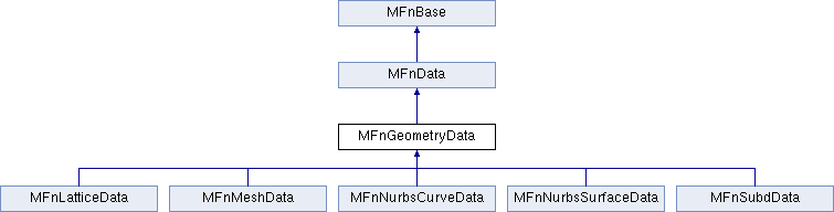

Inheritance diagram for MFnGeometryData:Public Member Functions | |

Reimplemented in MFnNurbsSurfaceData, MFnNurbsCurveData, MFnSubdData, MFnMeshData, and MFnLatticeData.
