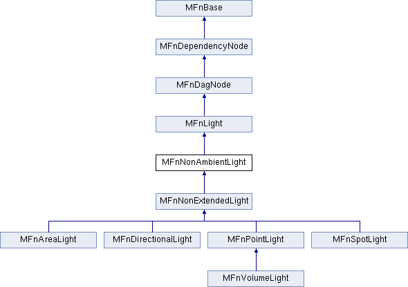

Inheritance diagram for MFnNonAmbientLight:Public Member Functions | |
