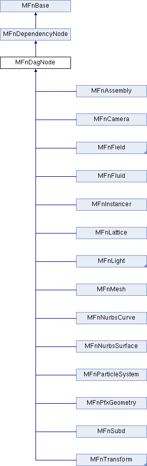

Inheritance diagram for MFnDagNode:Public Types | |

Public Member Functions inherited from MFnBase | |
| virtual | ~MFnBase () |
| Class Destructor. More... | |
| bool | hasObj (MFn::Type) const |
| Determines whether or not the Function Set is compatible with the specified Maya Object within the API RTTI system. More... | |
| bool | hasObj (const MObject &) const |
| MObject | object (MStatus *ReturnStatus=NULL) const |
| Returns the MObject that is attached to the Function Set. More... | |

virtual |
Function set type.
Return the class type : MFn::kDagNode.
Reimplemented from MFnDependencyNode.
Reimplemented in MFnSubd, MFnMesh, MFnTransform, MFnNurbsSurface, MFnNurbsCurve, MFnAssembly, MFnParticleSystem, MFnIkJoint, MFnLattice, MFnRotateManip, MFnScaleManip, MFnToggleManip, MFnDirectionManip, MFnFreePointTriadManip, MFnSpotLight, MFnStateManip, MFnCircleSweepManip, MFnCurveSegmentManip, MFnHikEffector, MFnPointOnCurveManip, MFnPointOnSurfaceManip, MFnDiscManip, MFnFluid, MFnIkEffector, MFnManip3D, MFnCamera, MFnDistanceManip, MFnDragField, MFnNewtonField, MFnNonAmbientLight, MFnNonExtendedLight, MFnRadialField, MFnVortexField, MFnAmbientLight, MFnAreaLight, MFnDirectionalLight, MFnGravityField, MFnLight, MFnPointLight, MFnTurbulenceField, MFnUniformField, MFnVolumeAxisField, MFnVolumeLight, MFnAirField, MFnField, MFnIkHandle, MFnInstancer, and MFnPfxGeometry.
protectedvirtual |
Class name.
Return the class name : "MFnDagNode".
