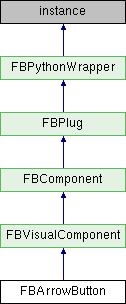

Inheritance diagram for FBArrowButton:Public Member Functions | |
