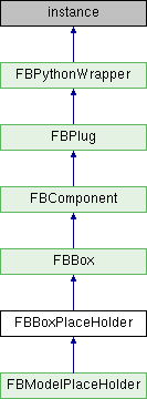

Inheritance diagram for FBBoxPlaceHolder:Public Member Functions | |
