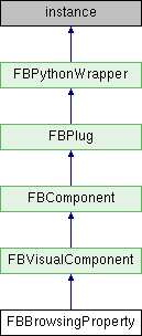

Inheritance diagram for FBBrowsingProperty:Public Member Functions | |
