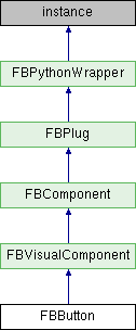

Inheritance diagram for FBButton:Public Member Functions | |
