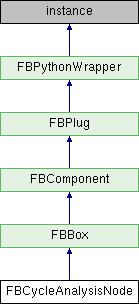

Cycle Analysis class.
Inheritance diagram for FBCycleAnalysisNode:Public Member Functions | |
