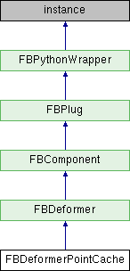

Base Model deformer class.
Inheritance diagram for FBDeformerPointCache:Public Member Functions | |
