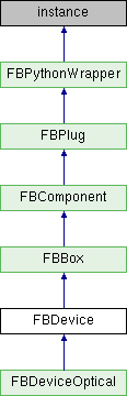

Base Device class. Cannot be instantiated from Python.
Inheritance diagram for FBDevice:Public Member Functions | |
