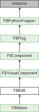

Text edit box.
Inheritance diagram for FBEdit:Public Member Functions | |
