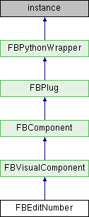

Number edit box.
Inheritance diagram for FBEditNumber:Public Member Functions | |
