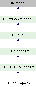

Inheritance diagram for FBEditProperty:Public Member Functions | |
