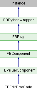

Inheritance diagram for FBEditTimeCode:Public Member Functions | |
