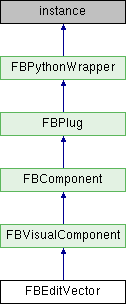

Inheritance diagram for FBEditVector:Public Member Functions | |
