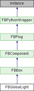

Inheritance diagram for FBGlobalLight:Public Member Functions | |
