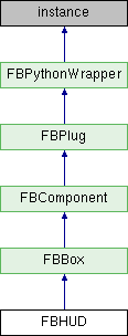

Inheritance diagram for FBHUD:Public Member Functions | |
