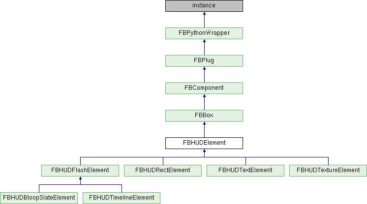

Inheritance diagram for FBHUDElement:Public Member Functions | |
