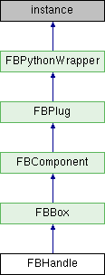

FBHandle class exposes the Handle object of the application.
Inheritance diagram for FBHandle:Public Member Functions | |
| __reduce__ () | |
| __init__ (object arg1, str arg2) | |
| Select (FBHandle arg1) | |
| Meta selection. More... | |
