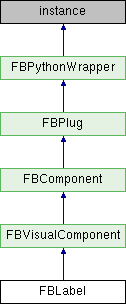

Text label.
Inheritance diagram for FBLabel:Public Member Functions | |
