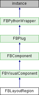

Inheritance diagram for FBLayoutRegion:Public Member Functions | |
