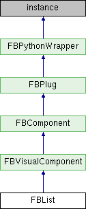

List of items.
Inheritance diagram for FBList:Public Member Functions | |
