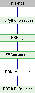

This class is an interface to manipulate object's containing in the scene.
Inheritance diagram for FBNamespace:Public Member Functions | |
