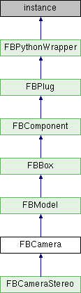

Inheritance diagram for FBCamera:Public Member Functions | |
