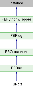

Inheritance diagram for FBNote:Public Member Functions | |
