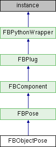

Class Description
FBObjectPose class.
This class exposes the object used to store the pose of objects.
+ Inheritance diagram for FBObjectPose:
