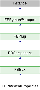

Base class for physical properties attach to a model.
Inheritance diagram for FBPhysicalProperties:Public Member Functions | |
