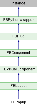

This class lets a window (inheriting from FBLayout) be created for another interface.
Inheritance diagram for FBPopup:Public Member Functions | |
