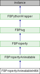

| | __reduce__ () |
| str | __repr__ (FBPropertyAnimatableInt64 arg1) |
| object | __str__ (FBPropertyAnimatableInt64 arg1) |
| | __init__ (...) |
| | __reduce__ () |
| str | GetDataTypeName (FBPropertyAnimatable arg1) |
| | Get the property datatype name. More...
| object | GetAnimationNode (FBPropertyAnimatable arg1) |
| | Get the animation node for the property. More...
| object | GetBox (FBPropertyAnimatable arg1) |
| | Get the owner box. More...
| bool | IsAnimated (FBPropertyAnimatable arg1) |
| | Is the property animated. More...
| bool | IsFocused (FBPropertyAnimatable arg1) |
| | Is the property focused (keyable). More...
| bool | OriIsAnimated (FBPropertyAnimatable arg1) |
| | Key (FBPropertyAnimatable arg1) |
| | Key the property. More...
| | KeyAt (FBPropertyAnimatable arg1, FBTime arg2) |
| | Key the property at time (t). More...
| | KeyRemoveAt (FBPropertyAnimatable arg1, FBTime arg2) |
| | Remove the key at time (t). More...
| | SetAnimated (FBPropertyAnimatable arg1, object arg2, object arg3) |
| | Set the animation state of the property. More...
| | SetFocus (FBPropertyAnimatable arg1, object arg2) |
| | Set the property's focus (keyable) state. More...
| bool | AllowsMuting (FBPropertyAnimatable arg1) |
| | AllowsMuting. More...
| bool | HasSomethingMuted (FBPropertyAnimatable arg1) |
| | HasSomethingMuted. More...
| bool | IsMuted (FBPropertyAnimatable arg1) |
| | IsMuted. More...
| bool | IsMemberMuted (FBPropertyAnimatable arg1, object arg2) |
| | IsMemberMuted. More...
| | SetMuted (FBPropertyAnimatable arg1, object arg2) |
| | SetMuted. More...
| | SetMemberMuted (FBPropertyAnimatable arg1, object arg2, object arg3) |
| | SetMemberMuted. More...
