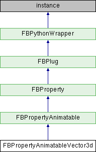

| | __reduce__ () |
| int | __len__ (FBPropertyAnimatableVector3d arg1) |
| | __setitem__ (FBPropertyAnimatableVector3d arg1, object arg2, object arg3) |
| float | __getitem__ (FBPropertyAnimatableVector3d arg1, object arg2) |
| str | __repr__ (FBPropertyAnimatableVector3d arg1) |
| object | __str__ (FBPropertyAnimatableVector3d arg1) |
| | __init__ (...) |
| | __reduce__ () |
| str | GetDataTypeName (FBPropertyAnimatable arg1) |
| | Get the property datatype name. More...
| object | GetAnimationNode (FBPropertyAnimatable arg1) |
| | Get the animation node for the property. More...
| object | GetBox (FBPropertyAnimatable arg1) |
| | Get the owner box. More...
| bool | IsAnimated (FBPropertyAnimatable arg1) |
| | Is the property animated. More...
| bool | IsFocused (FBPropertyAnimatable arg1) |
| | Is the property focused (keyable). More...
| bool | OriIsAnimated (FBPropertyAnimatable arg1) |
| | Key (FBPropertyAnimatable arg1) |
| | Key the property. More...
| | KeyAt (FBPropertyAnimatable arg1, FBTime arg2) |
| | Key the property at time (t). More...
| | KeyRemoveAt (FBPropertyAnimatable arg1, FBTime arg2) |
| | Remove the key at time (t). More...
| | SetAnimated (FBPropertyAnimatable arg1, object arg2, object arg3) |
| | Set the animation state of the property. More...
| | SetFocus (FBPropertyAnimatable arg1, object arg2) |
| | Set the property's focus (keyable) state. More...
| bool | AllowsMuting (FBPropertyAnimatable arg1) |
| | AllowsMuting. More...
| bool | HasSomethingMuted (FBPropertyAnimatable arg1) |
| | HasSomethingMuted. More...
| bool | IsMuted (FBPropertyAnimatable arg1) |
| | IsMuted. More...
| bool | IsMemberMuted (FBPropertyAnimatable arg1, object arg2) |
| | IsMemberMuted. More...
| | SetMuted (FBPropertyAnimatable arg1, object arg2) |
| | SetMuted. More...
| | SetMemberMuted (FBPropertyAnimatable arg1, object arg2, object arg3) |
| | SetMemberMuted. More...
| | __init__ (...) |
| | Constructor. More...
| | __reduce__ () |
| FBStringList | GetEnumStringList (FBProperty arg1, object arg2) |
| | String list for enum properties. More...
| str | GetName (FBProperty arg1) |
| | Get the property's name. More...
| | SetName (FBProperty arg1, str arg2) |
| | Set the property's name. More...
| FBPropertyType | GetPropertyType (FBProperty arg1) |
| | Get the property's type. More...
| | ModifyPropertyFlag (FBProperty arg1, FBPropertyFlag arg2, object arg3) |
| | ModifyPropertyFlag. More...
| int | GetPropertyFlags (FBProperty arg1) |
| | GetPropertyFlags. More...
| bool | GetPropertyFlag (FBProperty arg1, FBPropertyFlag arg2) |
| | GetPropertyFlag. More...
| str | GetPropertyTypeName (FBProperty arg1) |
| | Get the property's type name. More...
| str | AsString (FBProperty arg1, FBDataAsStringFlag arg2) |
| | Get the property value as a string. More...
| bool | SetString (FBProperty arg1, str arg2) |
| | Set the property value from a string. More...
| str | OriValueAsString (FBProperty arg1) |
| | Get the property original value (before any modification) as string. More...
| bool | IsAnimatable (FBProperty arg1) |
| bool | IsInternal (FBProperty arg1) |
| bool | IsList (FBProperty arg1) |
| | Verify if property is of this type. More...
| bool | IsObjectList (FBProperty arg1) |
| | Indicate if is an instance of FBPropertyListObject. More...
| bool | IsReadOnly (FBProperty arg1) |
| | Is property read-only? More...
| bool | IsMinClamp (FBProperty arg1) |
| | Indicate if minimum value clamping will be applied on user input value. More...
| bool | IsMaxClamp (FBProperty arg1) |
| | Indicate if maximum value clamping will be applied on user input value. More...
| bool | IsTextureConnectableProperty (FBProperty arg1) |
| bool | IsReferenceProperty (FBProperty arg1) |
| bool | IsUserProperty (FBProperty arg1) |
| | SetMin (FBProperty arg1, object arg2, object arg3) |
| | SetMin. More...
| | SetMax (FBProperty arg1, object arg2, object arg3) |
| | SetMax. More...
| float | GetMin (FBProperty arg1) |
| | GetMin. More...
| float | GetMax (FBProperty arg1) |
| | GetMax. More...
| bool | AllowsLocking (FBProperty arg1) |
| | AllowsLocking. More...
| bool | HasSomethingLocked (FBProperty arg1) |
| | HasSomethingLocked. More...
| bool | IsLocked (FBProperty arg1) |
| | IsLocked. More...
| bool | IsMemberLocked (FBProperty arg1, object arg2) |
| | IsMemberLocked. More...
| | SetLocked (FBProperty arg1, object arg2) |
| | SetLocked. More...
| | SetMemberLocked (FBProperty arg1, object arg2, object arg3) |
| | SetMemberLocked. More...
| int | GetSubMemberCount (FBProperty arg1) |
| | GetSubMemberCount. More...
| str | EnumList (FBProperty arg1, object arg2) |
| | Return the string of an enum value. More...
| | NotifyEnumStringListChanged (FBProperty arg1) |
| | Notify system that the enum list was modified. More...
| | __init__ (...) |
| | __reduce__ () |
| bool | BeginChange (FBPlug arg1) |
| | Begins a change on multiple plugs. More...
| str | ClassName (FBPlug arg1) |
| | internal System vars. More...
| bool | ConnectDst (FBPlug arg1, FBPlug arg2, FBConnectionType arg3) |
| | Add a destination connection. More...
| bool | ConnectDstAt (FBPlug arg1, object arg2, FBPlug arg3, FBConnectionType arg4) |
| bool | ConnectSrc (FBPlug arg1, FBPlug arg2, FBConnectionType arg3) |
| | Add a source connection. More...
| bool | ConnectSrcAt (FBPlug arg1, object arg2, FBPlug arg3, FBConnectionType arg4) |
| | DisconnectAllDst (FBPlug arg1) |
| | Remove all destination connections. More...
| | DisconnectAllSrc (FBPlug arg1) |
| | Remove all source connections. More...
| bool | DisconnectDst (FBPlug arg1, FBPlug arg2) |
| | Remove a destination connection. More...
| bool | DisconnectDstAt (FBPlug arg1, object arg2) |
| | Remove a destination connection at a specified index. More...
| bool | DisconnectSrc (FBPlug arg1, FBPlug arg2) |
| | Remove a source connection. More...
| bool | DisconnectSrcAt (FBPlug arg1, object arg2) |
| | Remove a source connection at a specified index. More...
| | EndChange (FBPlug arg1) |
| | Ends a change on multiple plugs. More...
| object | GetDst (FBPlug arg1, object arg2) |
| | Get a destination connection's plug at specified index. More...
| int | GetDstCount (FBPlug arg1) |
| | Get destination connection count. More...
| FBConnectionType | GetDstType (FBPlug arg1, object arg2) |
| | Get a destination connection's type at specified index. More...
| object | GetOwned (FBPlug arg1, object arg2) |
| | Get the owned plug at specified index. More...
| int | GetOwnedCount (FBPlug arg1) |
| | Get the owned plug count. More...
| object | GetOwner (FBPlug arg1) |
| | Get the owner of this plug. More...
| object | GetSrc (FBPlug arg1, object arg2) |
| | Get a source connection's plug at specified index. More...
| int | GetSrcCount (FBPlug arg1) |
| | Get source connection count. More...
| FBConnectionType | GetSrcType (FBPlug arg1, object arg2) |
| | Get a source connection's type at specified index. More...
| bool | Is (FBPlug arg1, object arg2) |
| | Is( int pTypeId ) More...
| bool | IsSDKComponent (FBPlug arg1) |
| | Return whether or not item is an SDK component. More...
| | MoveSrcAt (...) |
| bool | ReplaceDstAt (FBPlug arg1, object arg2, FBPlug arg3) |
| | Replace a destination connection at a specified index. More...
| bool | ReplaceSrcAt (FBPlug arg1, object arg2, FBPlug arg3) |
| | Replace a source connection at a specified index. More...
| bool | SwapSrc (FBPlug arg1, object arg2, object arg3) |
| | Swap source connection at index A with source connection at index B. More...
| | SetSelfModified (FBPlug arg1, FBPlugModificationFlag arg2, object arg3) |
| | Set the plug's self modification flag. More...
| bool | GetSelfModified (FBPlug arg1, FBPlugModificationFlag arg2) |
| | Tell if the plug's self has changed. More...
| | SetContentModified (FBPlug arg1, FBPlugModificationFlag arg2, object arg3) |
| | Set the plug's owned property/object's modification flag. More...
| bool | GetContentModified (FBPlug arg1, FBPlugModificationFlag arg2) |
| | Tell if the plug's content has changed. More...
| int | GetPlugConnectionModifiedList (FBPlug arg1, FBPlugList arg2, FBPlugModificationFlag arg3, object arg4) |
| | Get plug's modified src/dst property/object connection added/removed List. More...
| bool | RevertModification (FBPlug arg1, FBPlugModificationFlag arg2) |
| | Revert the plug's modification to original status. More...
| | __init__ (...) |
| method | staticmethod (function) |
| | __reduce__ () |
| | __init__ (...) |
