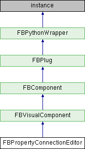

Inheritance diagram for FBPropertyConnectionEditor:Public Member Functions | |
