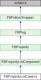

Inheritance diagram for FBPropertyListCamera:Public Member Functions | |
