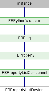

PropertyList: Device
Inheritance diagram for FBPropertyListDevice:Public Member Functions | |
