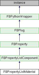

Inheritance diagram for FBPropertyListMaterial:Public Member Functions | |
