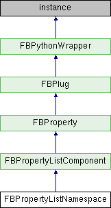

Inheritance diagram for FBPropertyListNamespace:Public Member Functions | |
