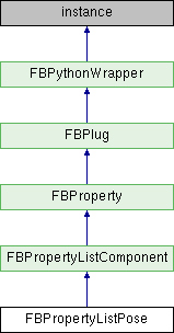

Inheritance diagram for FBPropertyListPose:Public Member Functions | |
