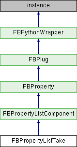

List: Take
Inheritance diagram for FBPropertyListTake:Public Member Functions | |
