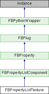

Inheritance diagram for FBPropertyListTexture:Public Member Functions | |
