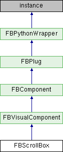

This class provides a layout that will be automatically managed with a scrollbar according to the specified width and height. This provides a way to add dynamic UI control.
Inheritance diagram for FBScrollBox:Public Member Functions | |
