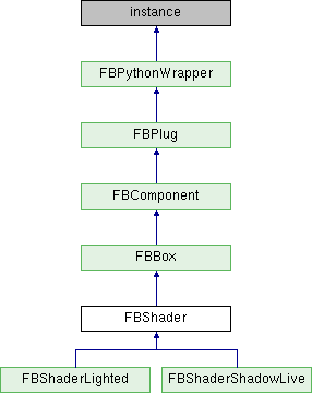

Shader class.
Inheritance diagram for FBShader:Public Member Functions | |
